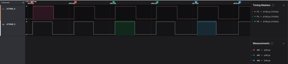

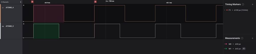

[EDIT]
Use an oscilloscope with sufficient speed and sampling buffer.
I was using a rough tool which was not allowing me to see into deep.

Associate II
I've used your code in a SPC5Studio project for Bernina MCU, and the correct value of Duty and Period are triggered.0693W00000KaFpaQAF.jpg
Come back to the original issue...
The TOM0_4 starts with settings period = 10000 and duty= 5000
The TOM0_3 starts with settings period = 10000 and duty= 4800
After 5 seconds (running) the duty of TOM0_3 is updated to 4600 using the API
gtm_tomUpdate_Duty_sync(&TOMD1, TOM_CHANNEL3, 4600);
(this API call the low level function gtm_tomSetCompareReg2())
Also in this case correct value are triggered.
If you are using the SPC5Studio in the attachment the project used.
Please focus in the GTM component configuration.
