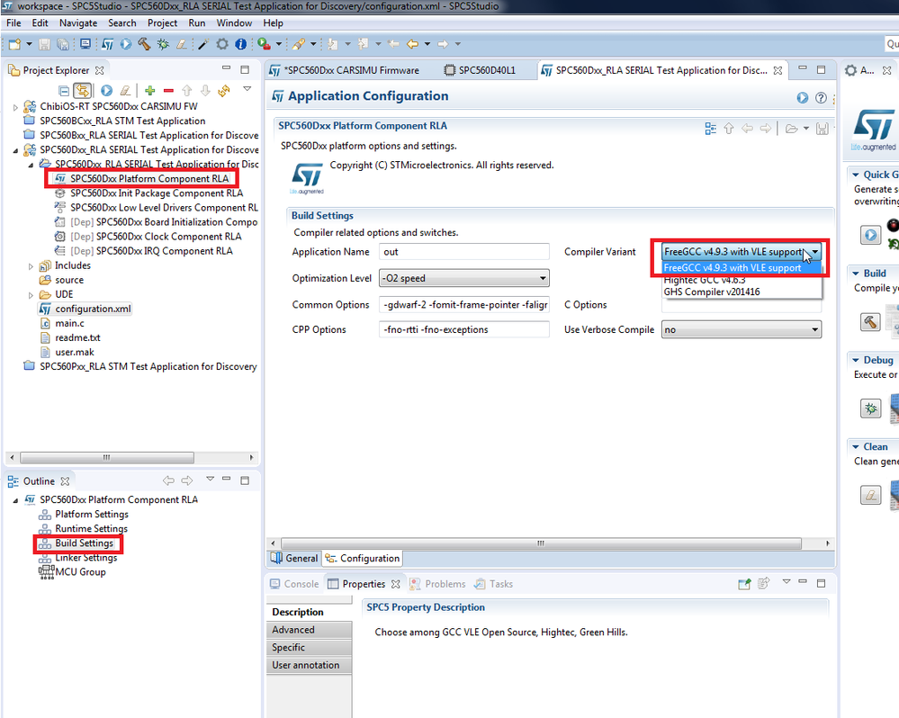

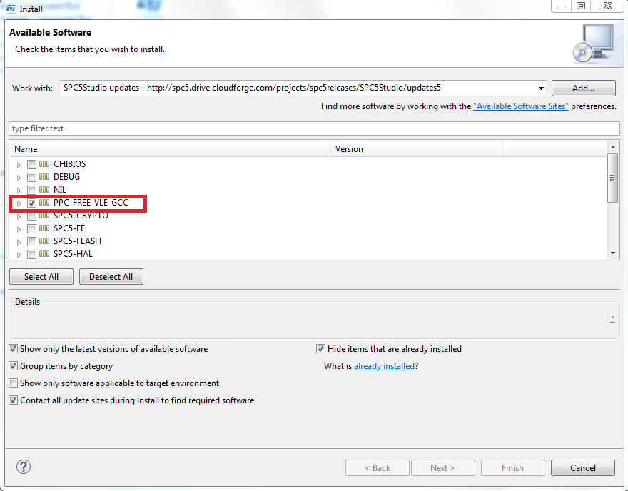

2017-01-03 6:53 AM
Hello rim ,
You can switch in the free license by updating your configuration :
here are the steps :
1) Install PPC-FREE-VLE-GCC from the update site (Install New Software) and restart SPC5Studio
2) Click on your Platform Component, Builld settings and change the compiler
Save and regenerate
Best regards
