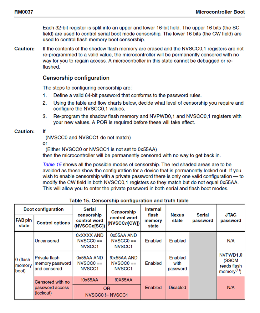

I use SPc560B54L5
How can i protect the controller from reading the program?
and how can i set the locks directly in Program?

Hello Vanima ,
you can use the censorship chapter in the RM (6.1.3)
the default password is : 0xFEED_FACE_CAFE_BEEF
Warning, PLS UDE 4.07.04 has a issue on the censorship.
PLS is working on the subject.
i advice to use TRACE32 Lautechbach

2017-01-04 1:23 AM
Latest SPC5-UDESTK 4.7.8 solves the issue in connecting censored devices.
However the professional PLS tools may allow to enable censorship by debugger as well.
