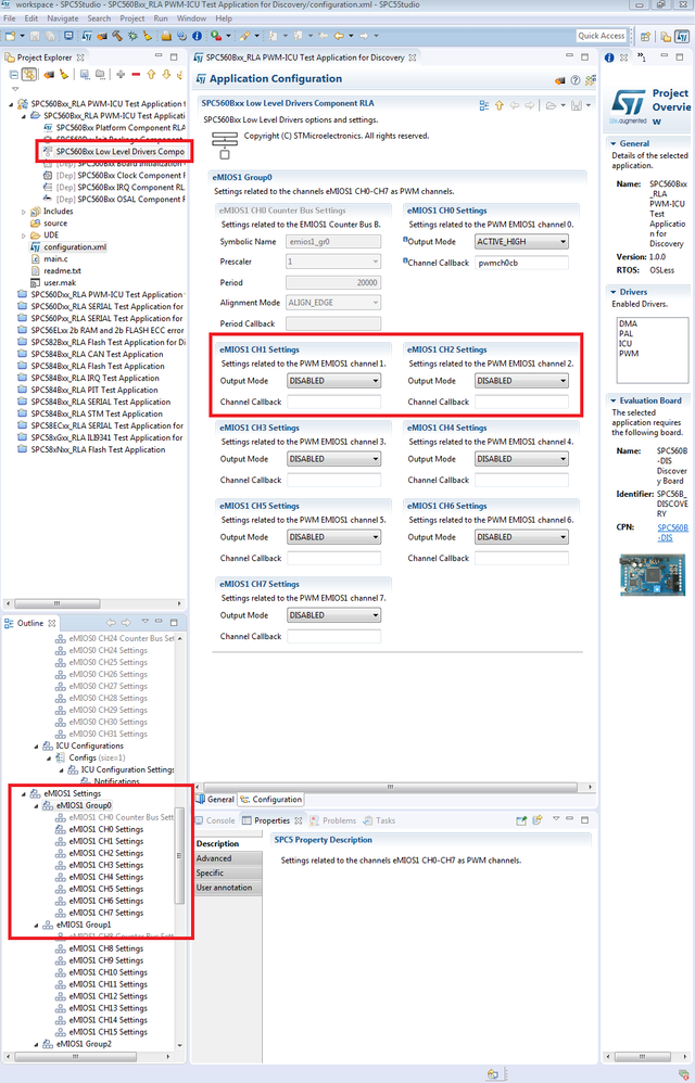

Hello Soni ,
If you use RLA drivers , you can change the configuration (cf screenshot)
Do not forget to generate after saving your configuration.xml
Best regards
Erwan

2017-11-23 2:32 AM
Hi Erwan,
thanks but want more info because I already set the channel configuration but in this channel callback also required? in for channel 1 and 2 ??whether I am using 0,1,2 or in ch 0 default callback is there.
