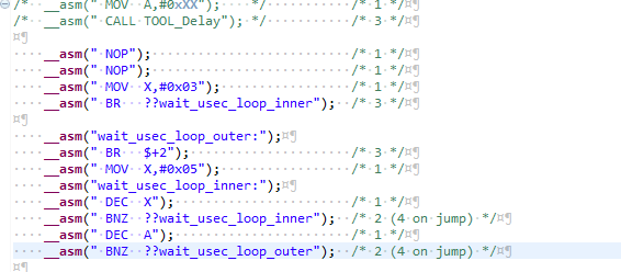

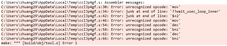

An errors occurred while compiling, see below:
assembler code:
build result:

Erwan YVIN
Hello ,
Which core do you use ?
you should refer to e200z0RM.pdf , e200z3RM.pdf or e200z4RM.pdf
Best Regards
Erwan

zeke.huang
Associate III
Hi Erwan,
I am using SPC560B50L1.
Best Regards
zeke
Erwan YVIN
Hello ,
SPC560B50L1 is part of e200z0 family
"The e200z0h core is a single-issue, 32-bit Power Architecture technology VLE-only design
with 32-bit general purpose registers (GPRs). All arithmetic instructions that execute in the
core operate on data in the general purpose registers (GPRs).
Instead of the base Power Architecture technology support, the e200z0h core only
implements the VLE (variable-length encoding) APU, providing improved code density."
For assembler code , please refer to the document e200z0RM.pdf
Best Regards
Erwan
