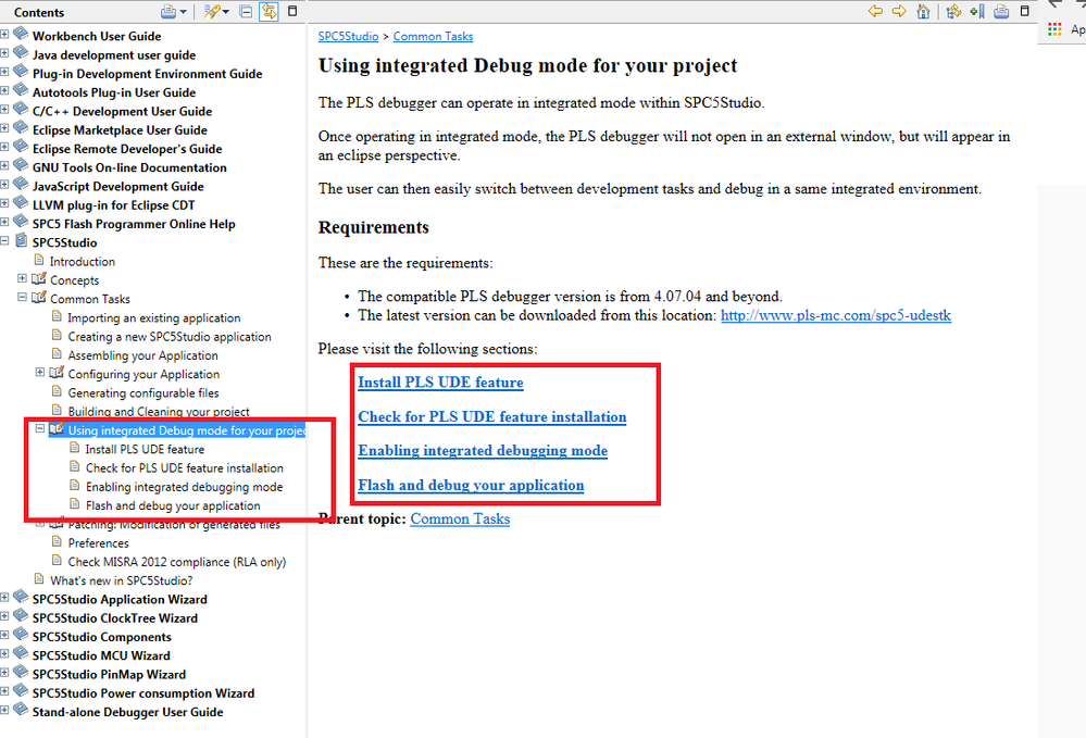

Hello Matthew ,
Did you install PLS UDE ?
https://pls-mc.com/login-a-html?User=SPC5UDESTKUser
there is 2 ways to debug
Anyway , PLS UDE should installed first.
Have you tried the help sections ?
Best regards
Erwan

Hello Matthew ,
For your information , we do not develop PLS Eclipse Integration plugins
The last version will still be in this following directory :
c:\Program Files (x86)\pls\UDE Starterkit 4.8\UDEEclipse4Integration.zip
Anyway , in some cases there is an issue linked to the PLS Workspace association in windows
cf ,
Best regards
