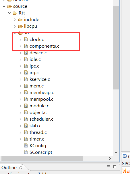

I would like to add some source files to the source folder. the files name are :clock.c and so on.
but
build faild.
I know that this is a problem in the makefile, and SP5Studio provides clock.c�?components.c .and My source files also have Clock.c and components.c...Causes the makefile rule to check for an error.

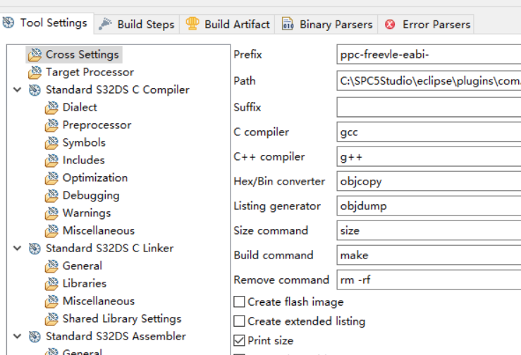

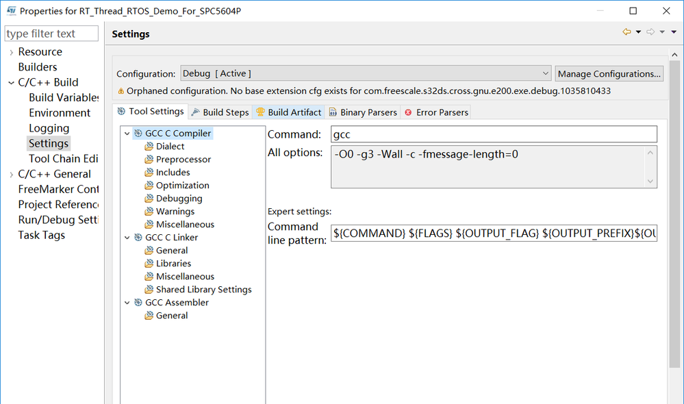

I saw the eclipse has provided a seemingly similar plug-in, anyway, looking forward to the Build plugin ~
Step 1:
step 2:

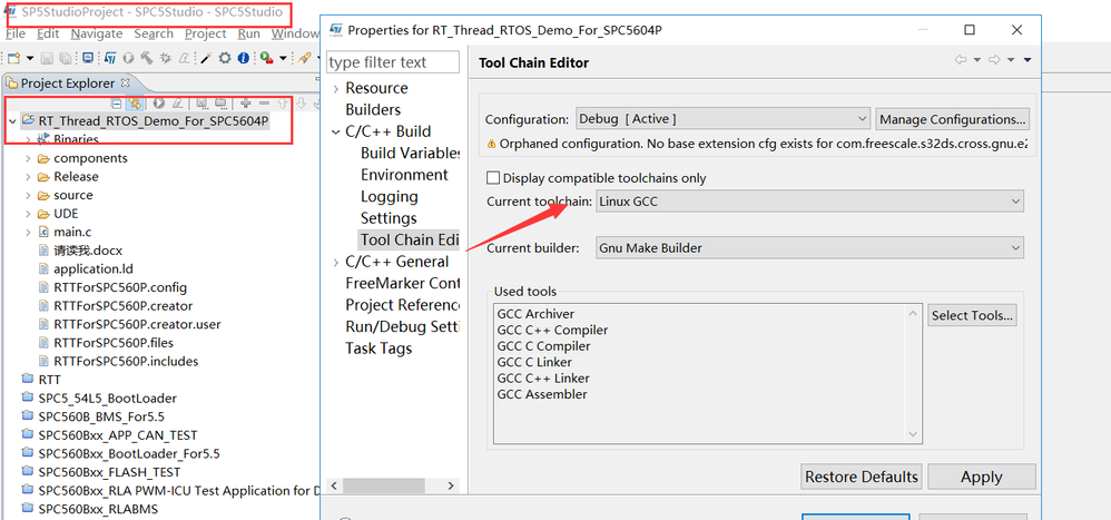

By the way, I am currently the RT-Thread RTOS ported to SPC5604B.

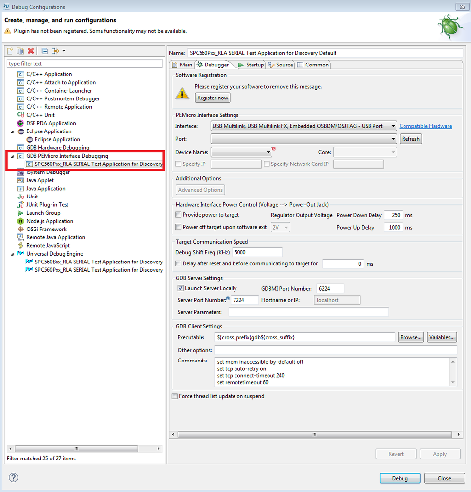

Can I debug SPC5604 with PE debugger of MPC5604?
Because the PLS debugger is too expensive.
I have a PE debugger that probably costs $ 30
2017-10-18 3:45 AM
Hello Guo ,
No problem for this ,
you can install it from
https://www.pemicro.com/blog/index.cfm?post_id=124
by update site mecanism . The link is on the blogChoose e200 target and create your de
Install is OK
It is not fully tested on our side. We have not PEMicro debugger.
i think that it should work if you create your appropriate debug configurations
Best regards
