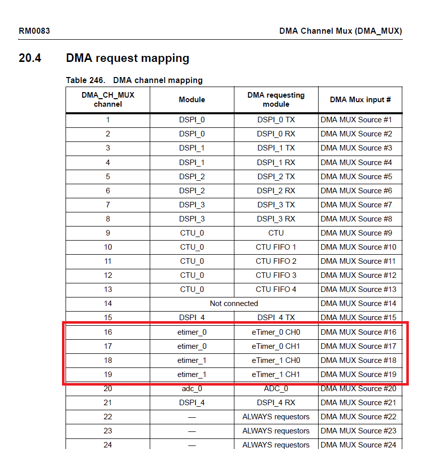

You can use DMA_MUX Channel 16,17,18,19 for eTimer
SPC5_ADC0_DMA_DEV_ID ==> Channel 16

Thanks for the reply. But what about switching the GPIO using the DMA (DMA transfers data between memory and GPIO). Is that possible?
I do not think it is from the following line in the manual,
DMA transfers possible between system memories, DSPIs, ADC, FlexPWM, eTimer and CTU
but just wanted to confirm with you.
In which case maybe I can use one of the DSPI pins to switch following a memory map? So using the DSPI pins to output a certain data from memory and make it function like a GPIO.

for GPIO Ports, you have to use the Onchip Memory
'Using the GPIO Ports to drive or sample waveforms. By configuring the DMA to transfer
data to one or more GPIO ports, it is possible to create complex waveforms usingtabular data stored in on-chip memory. Conversely, using the DMA to periodicallytransfer data from one or more GPIO ports, it is possible to sample complex waveformsand store the results in tabular form in on-chip memory.'Use eTimer /CTU/DSPI (Cf Table 246).
if you enable DMA Transfer for eTimer ICU, the DMA Interrupt will be handled not the ICU Interrupt.
Check DMA MUX (Chapter 20)

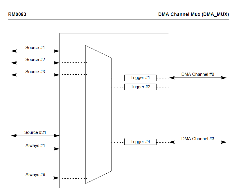

I looked at the section you referenced and it mentions to use a PIT to configure a periodic SPI or GPIO transfer.
But in the PIT section, there is no information on how to setup trigger for DMA? Is it automatic i.e as soon as I enable the PIT, will it generate a continuous trigger depending on its period? Do I need to enable the PIT interrupt?
'Besides the normal routing functionality, the first four channels of the DMA Mux provide a special periodic triggering capability that can be used to provide an automatic mechanism to transmit bytes, frames or packets at fixed intervals without the need for processor intervention. The trigger is generated by the Periodic Interrupt Timer (PIT); as such, the configuration of the periodic triggering interval is done via configuration registers in the PIT. Please refer to Chapter 31: Periodic Interrupt Timer (PIT) for more information on this topic'

Hello Raghu ,
the PIT is used only for the DMA triggering.
First , configure 1 PIT channel (#1 , #2, #3 or #4) with your timer settings
Second, you have to use the corresponding DMA Channel #0 to DMA Channel #3 in settings the good source..
Best regards
