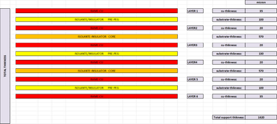

Hi, i have seen the gerber file of this evaluation board. About the plane, how the layer are counted? First layer top, second layer GND, third layer VCC_EXT, four layer GND. I am correct or i did a mistake? In the datasheet there is nothing about this. can you tell me how much layer are there and what signal are they connected?
2025-09-18 1:15 AM
This is the board stack-up, assuming you are talking about AEK-POW-BMSLV
Best Regards,
AutoDevKit Team
2025-09-18 1:31 AM
what signal are the layers conneted?
2025-09-18 3:16 AM
You can check from the gerber file. We do not provide support on layout technics in this Community.
