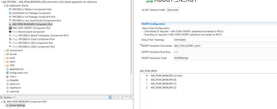

In AutoDevKit studio there is a demo named: SPC58EC - AEK_POW_BMS63EN_SOC_Estimation_Centralized application for discovery in which 3 BMS63EN nodes communicates, using 1 ISOSPI.
I suggest you to try it out, Clicking on the AEK-POW-BMS63EN component
Then remove 1 node from the chain:
Save, and then compile your project.
If you want to customize your BMS settings, then you should create a new AutoDevKit project including the improved BMSCHAIN component!
I suggest you to follow the BMS user manual. (UM3183, from page 27)
PS. Make sure to include the Model libraries and the application specific code from another BMS CHAIN Component example if you need SOC estimation.
