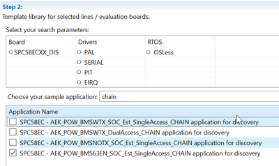

In you your case. the best example to start with is the CHAIN one single or dual access:
