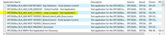

I am using SPC58 MCU and Autodevkit IDE. In that I have taken Avas_Compact_Test_Application example as the base source code

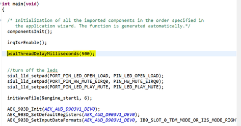

1. And, During execution, before integration of FreeRtos the execution was entering osalThreadDelayMilliseconds() and coming out of it and executing further code, but after integration of FreeRtos, the execution is entering osalThreadDelayMilliseconds() but not coming out of that API and further code is not getting executed. I have not modified anything in the base source code expect integration of FreeRtos even though I'm facing this problem. Can anyone help me to come out this problem.

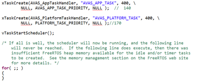

1. I have created two tasks -
a. AVAS_AppTaskHandler
b. AVAS_PlatformTaskHandler
2. Inside AVAS_AppTaskHandler, I have called Rx_Callback function and all the millisecond functions for Tx messages and I have implemented the timers. It is building through but communication is not happening.

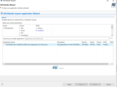

I took FreeRtos example(as shown in the snippet) as the base source code and integrated AEK-AUD-D903V1 RLA component. After integration, "AEK_903D_Init(AEK_AUD_D903V1_DEV0)" API is not getting initialized. The execution is getting stucked inside this API.
