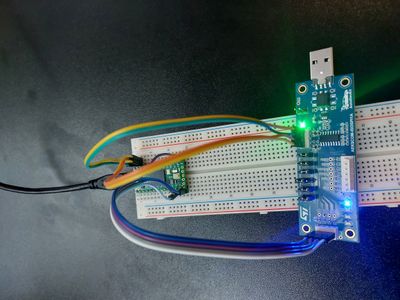

I was exploring AEK-COM-ISOSPI1, SPI to isoSPI dongle, based on L9963T transceiver for one of my new project. I wanted to make use of this interface product for a simulating software that runs on a Teensy 4.0 microcontroller. I have verified that the SPI data is received to the board, but unfortunately no signal was available on the isoSPI end. The setup and scenario is as below:
Teensy 4.0 (at 2MHz, SPI Mode0) acts as Master and I need this board to be on slave mode. Hence, I kept the jumper NSLAVE at JP1=0. The signals at SCK (TP6), SDI (TP7) and NCS (TP8) looks good as expected which was sent from the Teensy microcontroller. VDD and VIO was set to 5V. The other jumper connections are not quite clear to me however I tried few combinations and none of them seems to give me the isoSPI signals. For example, I tried TXAmp =0, TXEN =1, ISOFreq=1, BNE=0 and DIS=0 (JP2-JP6 respectively). I have also measured the signals at the L9963T pins input and all looks good. It seems like the conversion is not working or my setup is not correct.
Could someone guide me where am I going wrong? I am new to this hence any help would be grateful.

I have tried as per your instructions as below:
Hence, I would like to inform you that the problem is still not resolved. Later today I will also try to do with AutoDevKit Studio example.
Thanks
