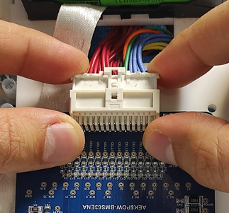

Note: Sometimes, even with the jumpers, this problem happens. That's because the BMS connector is not inserted correctly. Try to reconnect it by pushing along the borders, uniformly, as in the picture:

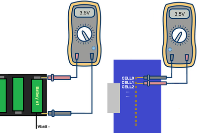

To check if the measurement are right I suggest to compare voltages as in the picture:

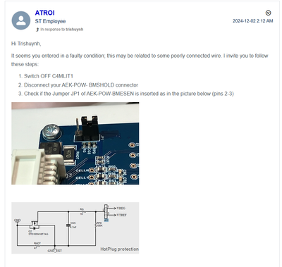

on 24/4/2025, When I changed the Jumper to pin 1 and 2, the voltage measurement is correct again. Before that, ASTROI suggest me to place the jumper at 2 and 3 but it still corrects.
However, the jumper on pin 2 and 3 is not correct so I have to replace the jumper to pin 1 and 2 as your instruction.
Could you please explain me clearly about the different between jumper on pin (1,2) and (2,3) and why now it is incorrect on jumper at pin (2,3)?
Updated: on 25/04/2025, the error happens again on both jumper on pin (1,2) and (2,3). Do you have any idea about this?

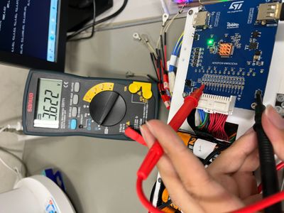

All of the connection from the holder to the board are ok and when I measure by using VOM on pin CELL 1 to 14 with GND_EXT the VOM returned 3.62 volt however the BMS still returned 3.51 volt. I dont understand that I have done something wrong or not?
Best regards,
TH
