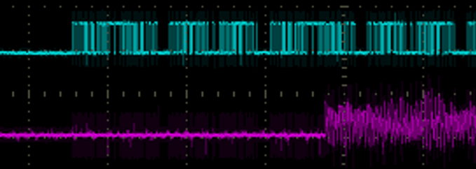

In the image below, the blue line represents the I2S SD, and the purple one represents the output analog signal from STA350BW to one of the two speaker.
There is a constant delay between start of I2S transmission and start of audio reproduction.
The delay is approximately 600/650 us.
Each sample should take 16us to be transmitted (16 bit - 1MHz).
Delay seems to be caused mainly by the STA350BW (default register configuration).
Is it possible to reduce this delay? Is there any default filtering configuration which may cause it?
