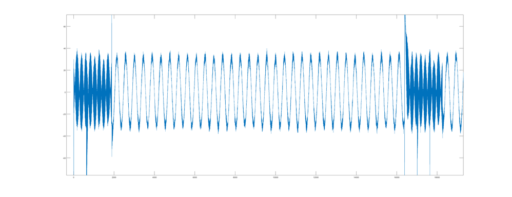

I attach 2 files with fragments of graphs. On the first one, I consider the values with indexes 4097-4103 (according to RM0433) as normal, but I have no idea where the values with indexes 4567-4576 come from. The situation repeats in every cycle. As an example, I attach the appearance of the beginning of the third cycle.

Interestingly, the A microphone has values in line with those expected. In each cycle, exactly the first 2 int16 values are incorrect, the rest are fine. But in microphones B, C and D, a sort of phase shift arises. I attach a graph of the entire PCM buffer, in which the next 4 values correspond to A, B, C, D respectively (A1,B1,C1,D1,A2,B2,C2,D2,A3,B3,C3,D3...). The same sound was fed to all 4 microphones, so a single (bold) sine wave should result. Unfortunately, there are offsets at the beginning of each cycle. Every cycle has 16384 values (4*4096).
