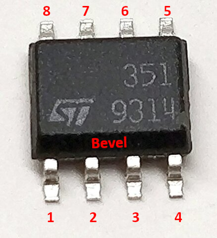

One side of the top should have a steeper angle than the orther. that is the side with pins 1 ,2,3,4....
2023-05-26 1:39 AM - edited 2023-11-20 4:37 AM
@BTign.1 if you mean the side with the bevel, then you are correct.

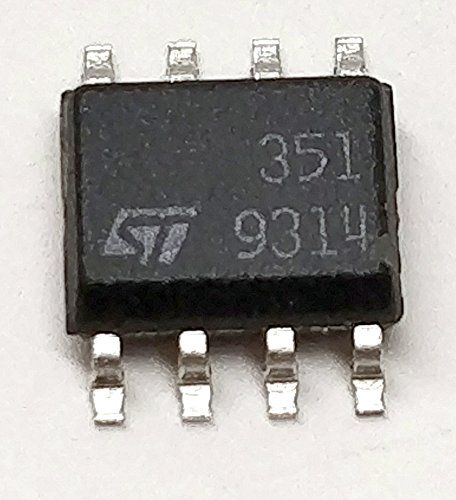

@arat.1 please find the drawing in the data sheet of the LF351. In your photo, pin 1 is on the left below the ST logo:
Regards
