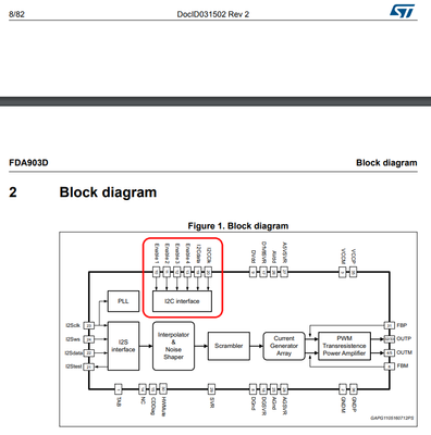

@Altun wrote:I want to play speaker only using I2C. is it possible
As the others have suggested, the datasheet will answer that; eg:
https://www.st.com/resource/en/datasheet/fda903d.pdf#page=9
You can see that the I2C is not in the audio path
