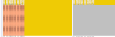

With STM32CubeProgrammer v2.21, there has been a change where the tool doesn't align automatically the payload to 0x400 with padding bytes for N6. Here's a screenshot of where the change is in an example binary:
