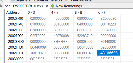

Screenshot: Stack while the code is flowing through that loop.
The only activity on the stack is the storage for the 32-bit counter variable; the stack pointer doesn't move in this section of the code.
