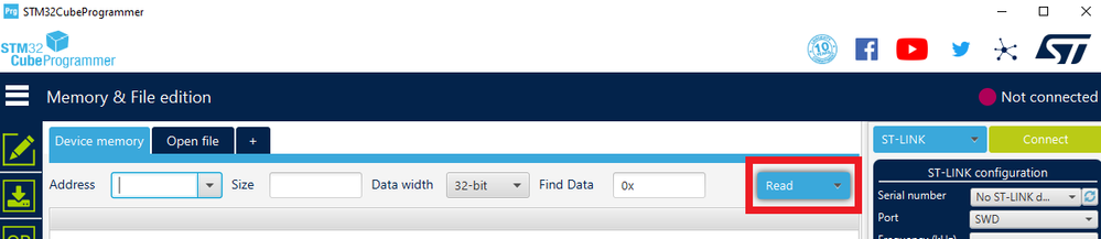

2022-04-03 11:27 PM
The external loader as be created by me, and this loader have a same configuration in booth places (external loader and application). I have too one SRAM on Bank 2 of FMC peripheral, and I can read and write correctly the values into the external SRAM. Only have issues when I try to read NOR FLASH.
The external loader only can read the values from the memory after click on "Read". My question is:
What is executed when I click in Read button on STM32CubeProgrammer (see image below). The STM32cubeProgrammer Read Button have some things more than read the memory only. I repeat the external loader are be created by me and the code of configuration (clock's, timings, GPIO and peripheral FMC) is the same in booth places, my code and external loader code.
Best regards,
