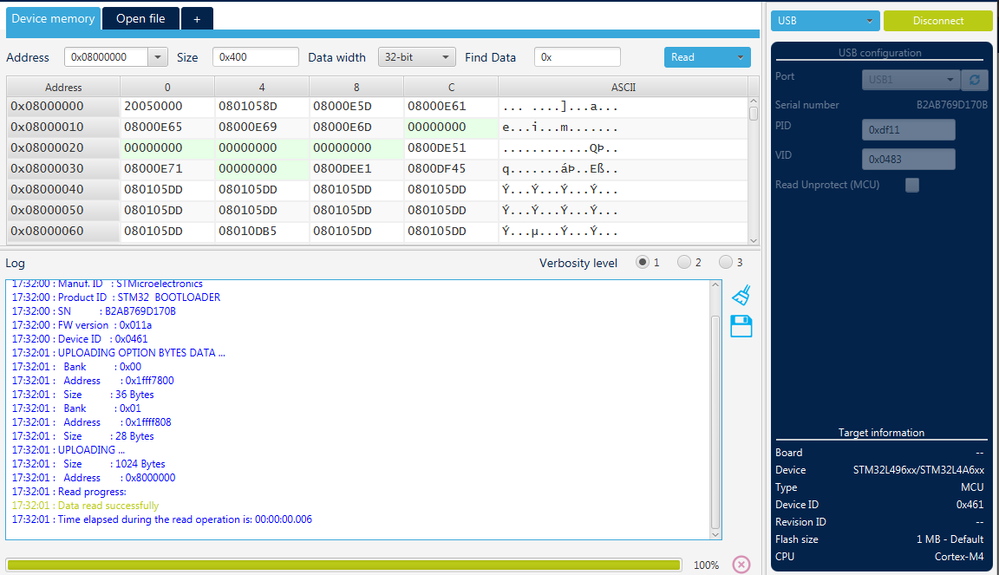

However, it seems that STM32Programmer works:
Questions:
  • Can I use the STM32 programmer to update the user flash with my HEX or DFU file? But then... How do I exit DFU mode????
  • Is there a reason why DfuSeDemo doesn't work? Is there anything else I need to worry about? That one has the handy "leave DFU mode" button.
