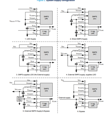

I had once an issue regarding:
Which system supply configuration you have on HW? (since for me, your Sch is not very clear)
Then, which one have you put in SW?
This can let you program your MCU for the first time, but after that first time, it would not boot again until you change it in HW to be as you programmed in SW (in the CubeMX).
Hope this helps.
Greetings
EDIT:
Seems like my guess was wrong, on what to look in, since the capture i posted is for H755 but for F423 there are few similar things that are called: Power Supply Supervisor, that do "the same" as my first guess, and what they do is to check some HW pins and connections with your firmware, as far as i understand at the end the "same thing" is happening, something you have in HW according to the Power Supply Supervisor is in conflict with the SW/FW you have loaded in the MCU, until you make the HW to be the same you have told to the MCU it have when you programmed it, it would not run.

@urbito wrote:Which system supply configuration you have on HW? (since for me, your Sch is not very clear)
@urbito
@urbito Where should I check whether it is HW/SW.? I do the Software Reset while programming. Please let me know where my mistake is.
2025-02-10 12:05 AM
You have to check the Datasheet for your microcontoller and there is a point regarding the "power supply" or something like that, where there are few examples of circuits needed to provide voltage to your microcontroller, and based on the used circuit, you have to make a configuration in CubeMX.
Hope it helps.
