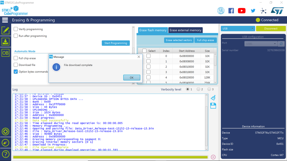

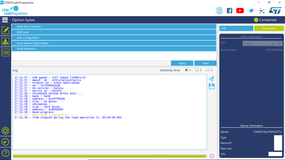

1) I am able to connect the STM32-Cube-Programmer in USB-DFU-mode if existing or loaded firmware in to STM32-target-board is not read-protected.
Image-1: Able to connect with target board
Image-2: Able to load firmware in to target board

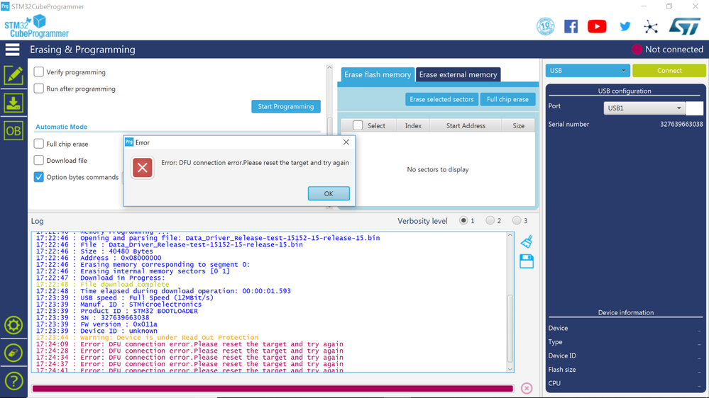

2) I am not able to connect the STM32-Cube-Programmer in USB-DFU-mode if existing or loaded firmware in to STM32-target-board is read-protected.
Image-3: Not even able to connect with target board
In this case I am keep getting the DFU connection error,
How to resolve this application bug.
Programmer seems to be not professionally viable,
Has anyone in community found resolution to this application bug.
Can anybody in STM comment?
