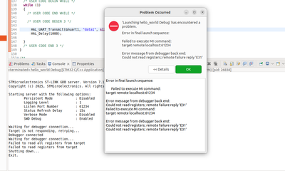

I’m working with the STSPIN32G4. I was able to program the MCU once successfully, but since then neither STM32CubeIDE nor STM32CubeProgrammer are able to detect it anymore.
The main issue is that I did not expose the BOOT0 pin on my board, so I can’t easily force it into system bootloader mode.
Has anyone faced a similar issue?
Is there any workaround without physical access to the BOOT0 pin?
Would SWD still work if the application firmware misconfigured the debug pins?
Any suggestions for recovering the MCU in this situation?
I’d really appreciate any help or guidance.
Thanks in advance!

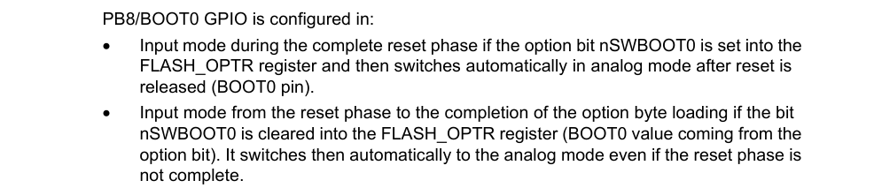

2025-08-18 2:42 AM - edited 2025-08-18 2:52 AM
BOOT0 has to be on GND level. No workaround , if used as BOOT0 .
Otherwise try connect under reset (with hardware reset , nrst connected);
then set option bytes ...to not use BOOT0 pin as BOOT0 .
from rm STM32G4 :

2025-08-19 2:55 AM
2025-08-19 3:29 AM
Have you tried a mass erase ?
The Cube programmer should support this.
The option byte and sector erase errors in the log file look strange, although I don't have any experience with the G431.
