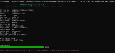

2025-02-12 1:08 AM
Hello @Maryem and thanks for your answer.
Trying to write to the FLASH_OPTSR_PRG is unsuccessfull.
But with cube programmer, I can see the following register with the value wanted
And now, Programing is working!!
so first, big thanks.
And second, what happens? and what was the purpose of the command (RDP? WRP? )?
