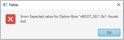

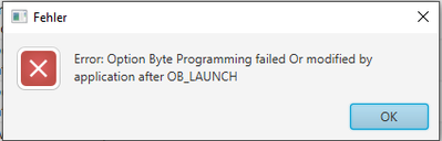

Now I will change the nBOOT_SEL to 1. After press "Applay" I become a error message:
And it is not changed. After press "Read" it show for me correct but after a POR it is not changed.
What must I do that work this correct?

2024-06-12 1:48 AM
Oh, I've vorgot my function in the application. I must remove it, it overwrite this.
Not it works fine :)
