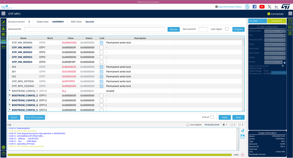

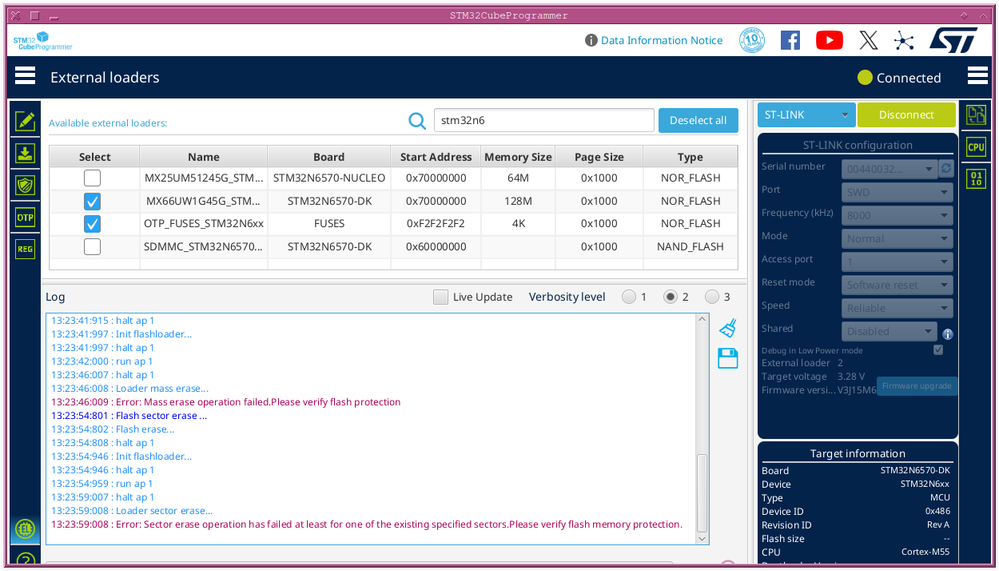

Hi, I can't erase the external flash or write a new binary on my STM32N6570-DK board. My problem is similar to this post: STM32N6570-DK: Cannot erase external Flash. But the solution in that post didn't work for me.
I have tried using two external loaders (MX66UW1G45G, OTP_FUSES) and also with only one loader (MX66UW1G45G). But everytime the erase is failed with this message: `Error: Mass erase operation failed. Please verify flash protection`.
I am sharing some screenshots and my OTP export for your reference.
Please let me know how to unlock the flash so I can program it.
OTP screenshot
2 loaders are selected here. But I tried with only one loader too.

Thank you. Setting the boot mode to "Development Boot" fixed the problem and now it's possible to write to the external flash. For STM32N6570-DK, the Dev_boot mode is set when BOOT1 switch position is 1-3, BOOT0 switch position doesn't matter.
As mentioned in the answer you shared:
The Dev_Boot has been designed to open the STM32N6 debug port to external tools for debugging applications and programming/erasing internal or external memory and also to fuse OTP bits (see RM0486 section 5 OTP mapping).
Thank you for your quick assistance.
