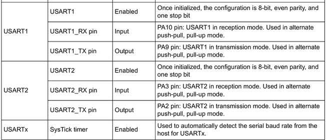

100K pullups on the TX and RX as per AN2606
BOOT1 pin pulled low, via 10K resistor for correct Boot config.

AN2606 say use one of
and init Pattern 1 (described in Table 2). Table 127

see page 39 AN2606 recommendations
