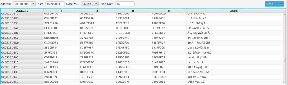

I'm facing this weird behavior with many STM32H7A3ZIT6 parts, where after we flash our Firmware, the MCU do not work and when we read the flash content, we can notice that one flash bank (1MB) is either corrupted with random data or erased. Sometimes we see Bank 0 in this state, other times Bank1.

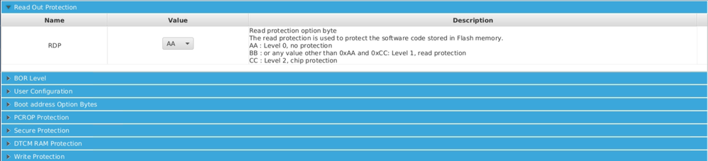

When this happens we check using STM32CubeProgrammer, the option bytes are normal (no read or write protection is checked), and more interestingly is that STLink returns a weird Flash Size Value

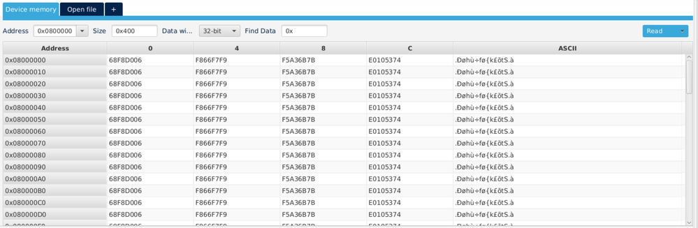

First Bank with random data
Second Bank is normal (has valid code)

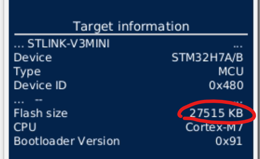

Invalid Flash Size (After mas erased this reads Ok, but fails again after FW is flashed)
While flashing the code, the STM32CubeProgrammer returns success, even though we can't read one of the banks properly.

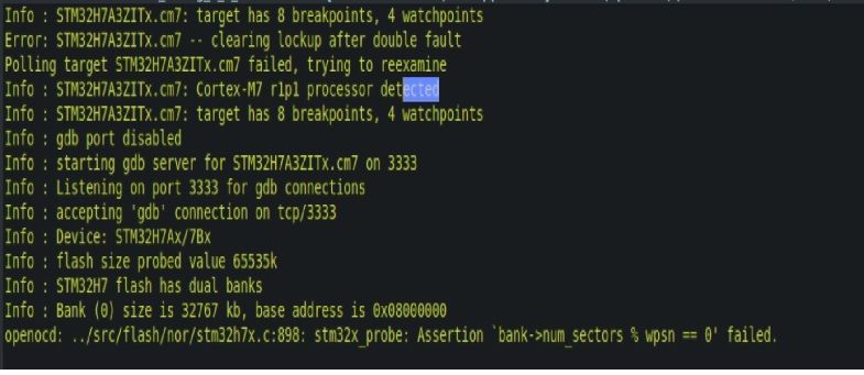

I've also tried flashing using STM32CubeIDE with OpenOCD but the problem persists.

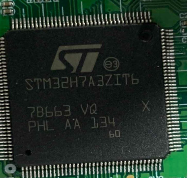

Below is the image of a Chip we are using

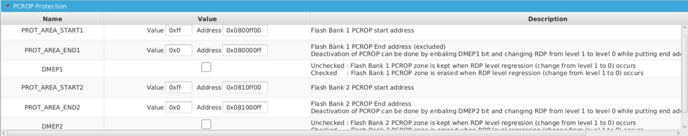

Option Bytes

@Community member When the MCU enters this state, and I remove all power supply and wait, I'm able to write the entire flash, but eventually the problem appears again after running for awhile
The MCU part I am using is LDO only, configured with VOS0 for 280MHz
