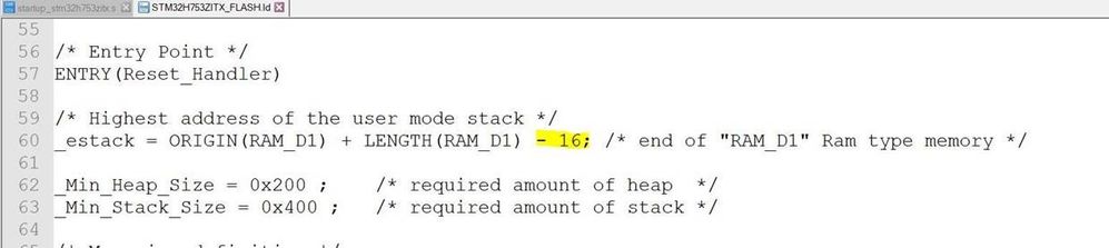

Here is the workaround: use a stack address that is always more than "End RAM @ - 16 bytes". For instance I changed my stack pointer from SP=0x24008000 to SP=0x24007FFF0.
This can be done by changing _estack in the linker file:
This issue originates from a bug in the new bootloader. Here is what happens when the SP is set to the end of RAM:
* A POP on the stack is done by the bootloader after setting the stack value in the code stack.
* As we are using the limit address of the RAM, this POP will cause a hard fault before the jump
This issue should only affect STM32H74xxx/75xxx rev V boards and will be documented in AN2606.

We've tested suggested workaround and it works. We are not entirely happy that it is needed but nevertheless, it is good we have answers now.
Also at some point ST team mentioned that compiler used to compile application affected the outcome of the test. We did not find that to be the case.
However it is worth mentioning that we are using arm-gcc.
