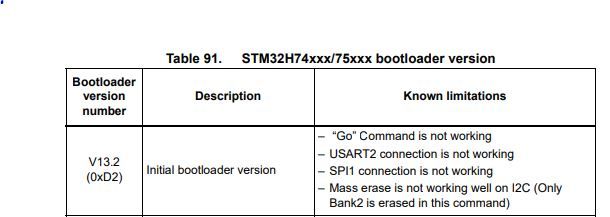

Note that in the AN2606, for the Bootloader version number V13.2 (0xD2): “Go�? Command is not working.

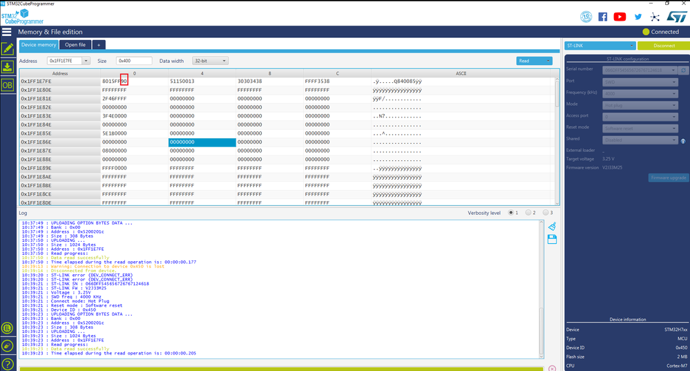

You should verify the Bootloader version using STM32CubeProgrammer at address 0x1ff1E7FE (please see attached picture: in red means I'm using version 9.0)

  1. STM32H753 Rev Y Bootloader version 0xD2 (13.2) (GO command works OK) - AN2606 states that it should not work.
  2. STM32H753 Rev V Bootloader version 0x90 (9.0) (GO command doesn't work) - All issues from 13.2 and 13.3 were supposed to be fixed here as per AN2606
All this is confusing
To summarize here:
Rev V is loaded with Bootloader version 9.0 and it is supposed to have all known limitations of 13.2 and 13.3 fixed (one of them being "Go Command is not working"),
but this is not the case.
In fact 13.2 is OK but 9.0 is not.
