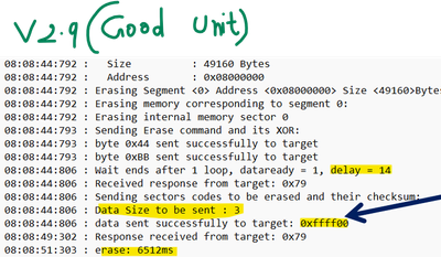

On few good units , erase takes around 6.5seconds with V2.9 STM32Cube prograamer.

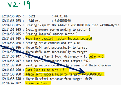

This issue doesnt occur when we use STM32 Cube prograamer V2.19. Erase takes around 4.8seconds

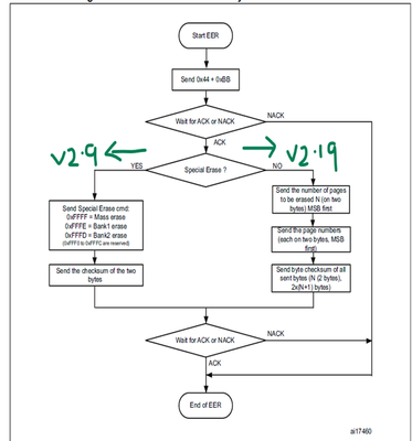

On checking the difference between the two VERSIONS we found the command sent for erase is different in both the versions of STM32 Cube Programmer.
V2.9 sends command 0xffff00 data size :3 Bytes. This is a mass erase.
While V2.19 sends 0X0000000000 DATA size: 5bytes. It is a page wise erase. The erase time taken by V2.19 is less compared to V2.19.

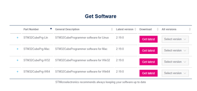

There is no version V2.9 for CubeProgrammer. The latest one is V2.19 as listed in the CubeProgrammer web link:
Could you please clarify?

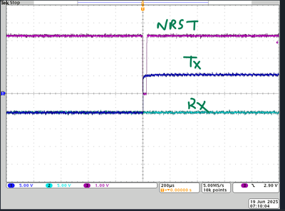

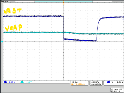

> On checking the NRST , it went low for around 30us .
Check RCC->CSR to see why the chip was reset. Perhaps a brown out condition, or IWDG. You could also check the TX/RX pins to see what is happening during the communication. Perhaps also NRST at the same time to see when the reset happens.

We have checked the TX and RX and at the same time NRST . There is no issue with the communication. Data seems fine . Also the issue happens occasionally and not on all the Units.

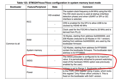

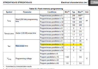

When our unit switches to the STM Bootloader, the IWDG timeout will be 16 seconds (32 kHz clock, pre-scaler set to 256 [Max Value] and window set to 2000) as per snapshot below. The max erase time for mass erase from datasheet is 16 seconds as well. The IWDG is what is enabled , while going to the bootloader from our application.

AN2606 says it refreshes the bootloader periodically but provides no other details.

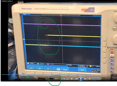

What is the time between command set and NRST going low due to IWDG? Can you show a scope plot of this?

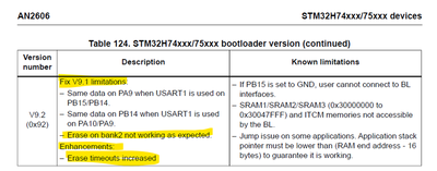

We are using software method to enter boot mode i.e. JumpToBootloader() function using discretes, we observe that the STM32 MCU enters the boot mode (UART) and responds to the ID, after the erase command no response. The issue happens during mass erase only on some units and its intermittent as well. There are no changes to microcontroller batch codes .
Our code uses the IWDG configured to reset if not serviced for 1 second (32 kHz clock, pre-scaler set to 16 and window set to 2000). The code application should service this every 50ms.
In the case of going to the bootloader from our code the IWDG will still be enabled. According to the Bootloader documentation as shown below: This means that once our unit switches to the STM Bootloader, the IWDG timeout will be 16 seconds (32 kHz clock, pre-scaler set to 256 [Max Value] and window set to 2000).
We tried to read the watchdog registers from the MCU when the bootloader is running. The prescale register was set to 256, so this should mean a 16 second reset.

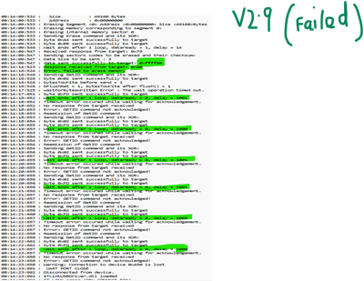

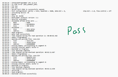

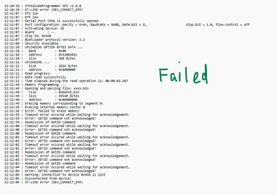

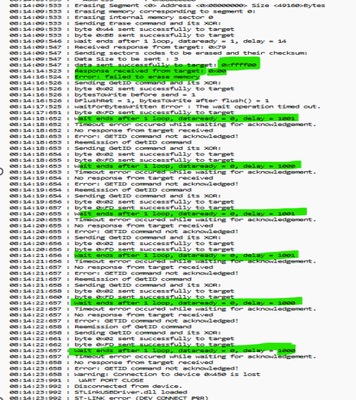

Refer the snapshot of the reset , RS232_RX & RS232_TX. Also the video snapshot shows that when reset occurs roughly around 10 sec and then no response.
I have attached the logs of good versus bad for more details of behavior. towards the end
