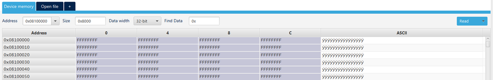

I am currently developing on the STM32H563ZI and encountered an issue where, when swapping to Bank 2 to erase/write flash, it simultaneously erases the same address in Bank 1. Here are the steps I followed:
At this point, the code initially flashed to 0x8100000 was erased. Subsequent tests with writing only a few bytes also resulted in the same situation.

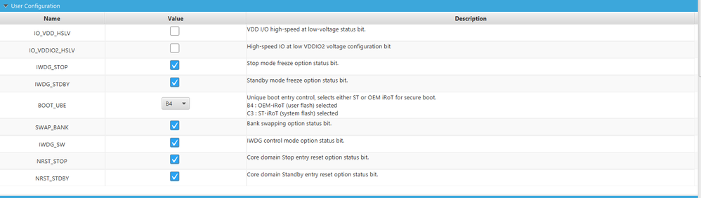

Thank you for your reply. The swap configuration is as follows:
Additionally, I performed other tests with similar results.

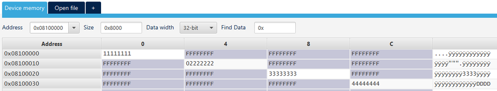

Step1:Erase all sectors
Step2:Swap_Bank set 1
Step3:Write some bytes to 0x8100000

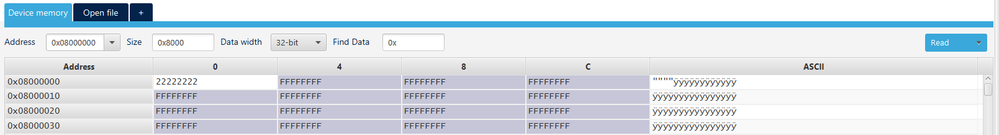

Step4:Write 4 bytes to 0x8000000
At the same time, the data originally written to 0x8100000 gets erased.
