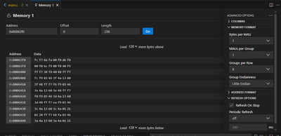

In this setup, after launching the debugger, I cannot find a way to inspect the values in Flash, RAM, or the registers of the Cortex-M33 peripherals.
Regarding memory, I tried installing the "MemoryView" extension, but I am still unable to view the values. Are there any alternative extensions with similar functionality?

Hi Fumihiko,
Unfortunately, it is not possible to view the Cortex-M registers yet, but this feature is planned in our roadmap.
Regarding the memory view, the STM32Cube for Visual Studio Code pack already includes a memory viewer, the one from CDT Cloud called Memory Inspector.
During a debug session, you can open the Memory Inspector via the Command Palette (Menu: View -> Command Palette...).
Then, filter the Command Palette by typing Memory: Show Memory Inspector.
After installing "Memory Inspector", I was able to check memory values during the debug session.
Thank you for your support.
