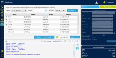

So if it stops, maybe you just have to "run" it again, see (whwn connected) in core/registers the green "run" :
cpu halted here (in my case on H7A3 also), if i just click on SWV.

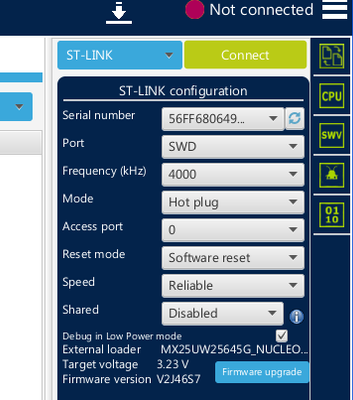

Try:
- set to hot plug , software reset
- connect
- then click SWV -> start (works?)

then try: in CubeProgrammer:
- connect (not click SWV !)
- if connect ok, target should still run fine ; then click SWV -> start (works?)
