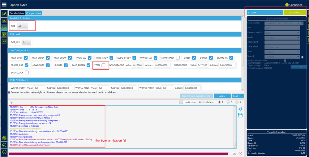

We encountered an issue with the STM32L562E-DK board when attempting to clear TZEN by changing the RDP level from 0 to 1 and then back to 0. Using the STM32CubeProgrammer, we can connect to the device via ST-LINK. The memory blank check indicates flash is empty, but the first byte verification fails during download. Additionally, the PC register value is 0xFFFF_FFFE, and the SP register value is 0xFFFF_FFFC.
Could you please provide guidance on resolving this issue?

I have set the option bytes with TZEN=0 and RDP=0, but why does the first byte still fail verification when starting from the on-chip flash?
I hope this helps with your technical support communication!
fail

I have used "Hot plug" to connect via JTAG/SWD, as shown in the last picture. Could you please advise which other option bytes need modification?
Thank you~

Since TZEN = 0, the address to download at is @0x08000000 not @0x0C000000, please make sure to have TrustZone disabled on your project too.
