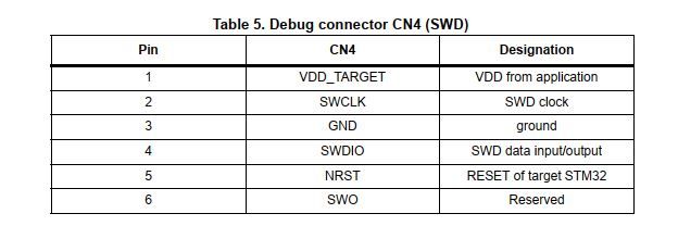

I have "Error: No STM32 target found!" and "Voltage: 0.01V" even if I have 3.3V on the pin 1 of the SWD connector and a high level on the NRST pin. I also tried some differents "Mode" and "Reset mode" configuration without success.

@Sco On the R22 resistor, I have 0V. But I use an old ST-Link cutted from an STM32F030R8 nucleo board. And this resistor is connected to the pin 6 (SWO - Reserved)
So, the component denomination could be different.
If I compare a nucleo schematic and mine, the "AIN_1" signal seems to be connected to the debug connector (pin 1) through a resistor not fitted. On my ST-Link, it seems to be the resistor R9 (not fitted) and I have 3.3V on it.
