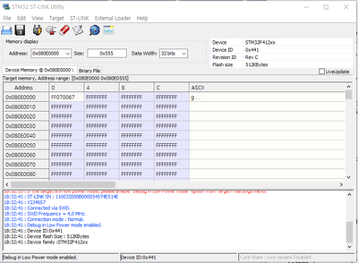

2025-07-14 6:43 AM
Please share the screen shot of your Cube Programmer after connecting to the MCU
2025-07-14 6:48 AM
I can not connect stm programer. I leave office.

2025-07-14 6:59 AM
Sorry i don't understand.
So can i don't use 0x80e0000?
2025-07-14 7:00 AM
I use 0x80e0000.
