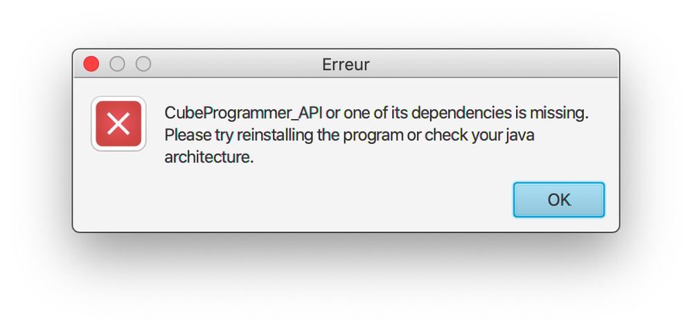

Hi there.
I used your advice to successfully install the application (using the .exe), but then it quite failed.
Starting the app directly (no exe, just the .app) obviously fails. Installer would not output a .exe , which could have been better but i found no way to make it think i was using windows.
I was able to start the application using
/Library/Java/JavaVirtualMachines/jdk1.8.0_202.jdk/Contents/Home/bin/java -jar STM32CubeProgrammer.app/Contents/MacOs/bin/STM32CubeProgrammerbut all i got was this:
Tried various -cp arguments, including all libs and whatevers i could find but was not able to please it. If you have any proposal for a fix, i'll be willing to check and report.
2020-09-10 6:05 AM
Hi @fred bar ,
Try to launch the command while beeing in CubeProgrammer install folder : STM32CubeProgrammer.app/Contents/MacOs/bin/.
Tell me please if it is OK.
regards,
Houda
