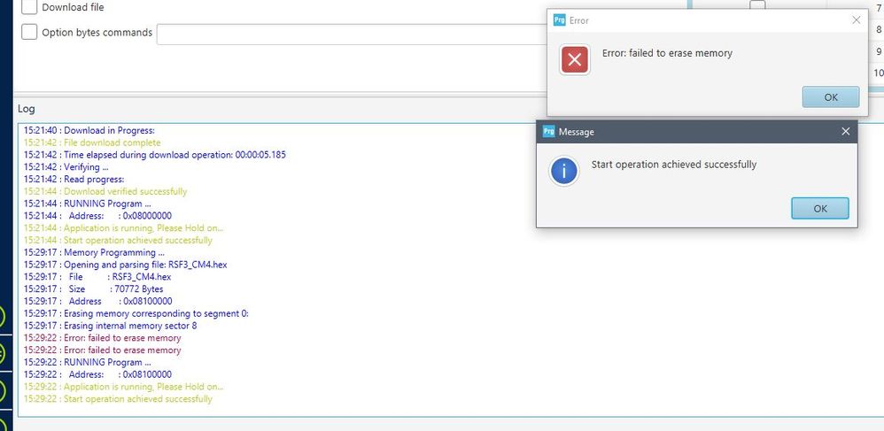

Since I am using the version v2.7.0, I get this error after programming both cores after the first time:
I can fix this by Disconnecting the STM32H7, and Connected again

Hi @Hans T
According to your debug traces your M7 application seems to be doing something perturbing Flashloader operations.
Let me explain what you are doing exactly :
What I recommend :
Hope it helps.
