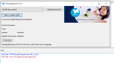

I have recently bought some STLINKV3-MINIE debug/programming probes but STM32CubeProgrammer does consider it "too recent" and I can not use them. I can not program with it, neither to update it.
I just need to program a binary file. No debug. No SWO. Just SWDIO/SWCLK.
Windows does detect it, and I can program with it using Simulink Embedded Coder Support Package, but I can not use it with STM32CubeProgrammer.

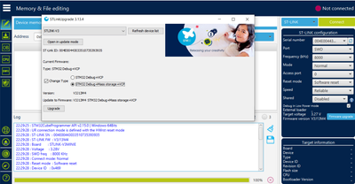

Ok, I can answer myself.
1) I can have multiple versions of STM32CubeProgrammer installed in same laptop, so I can have 2.6.0 for Simulink support package and 2.15.0 for fast programming .bin files using newer debug probes like STLINKV3-MINIE.
2) If you change the STLINK firmware type to "Debug+Mass Storage+VCP" (using 2.15.0) it becomes usable by STM32CubeProg 2.6.0.
Hope it helps!
