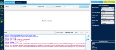

I'm trying to connect to the board using the STM32CubeProgrammer, but am running into issues. With the GUI, I get the following:
16:30:49 : UR connection mode is defined with the HWrst reset mode
16:30:54 : xxxxxxxx ---> (have removed SN here, it does show valid number)
16:30:54 : Error: J-Link - Connection to target failed
16:30:54 : Error: J-Link - Reading CPUID failed
16:30:54 : Voltage : 3.31V
16:30:54 : Error: Database cannot be found. DatabasePath = /Applications/STMicroelectronics/STM32CubeProgrammer/STM32CubeProgrammer.app/Contents/MacOs/bin/../Data_Base/STM32_Prog_DB_0xAAA.xml
16:30:54 : Error: flash loader cannot be loaded. FlashLoaderPath = /Applications/STMicroelectronics/STM32CubeProgrammer/STM32CubeProgrammer.app/Contents/MacOs/bin/FlashLoader/0xAAA.stldr

Any ideas what I can try? I'm using an M1 mac, if you think that might be an issue/something extra I should configure?

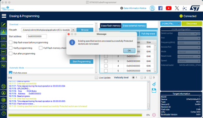

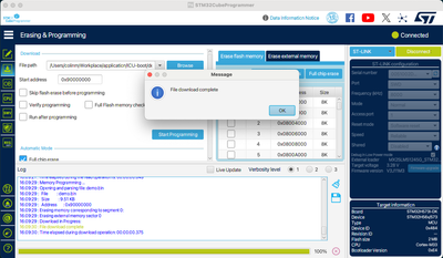

I'm trying to interact with the external flash on the DK, and having some more issues. I'm using the `MX25LM51245G_STM32H573I-DK-RevB.stldr` external loader. I can read the flash and erase sectors, but the program immediately crashes when I try to program a file.
Using the ST-LINK with the same external loader and the same .bin, I can program successfully:
Using the J-Link, I can read and erase sectors successfully, but not program:
