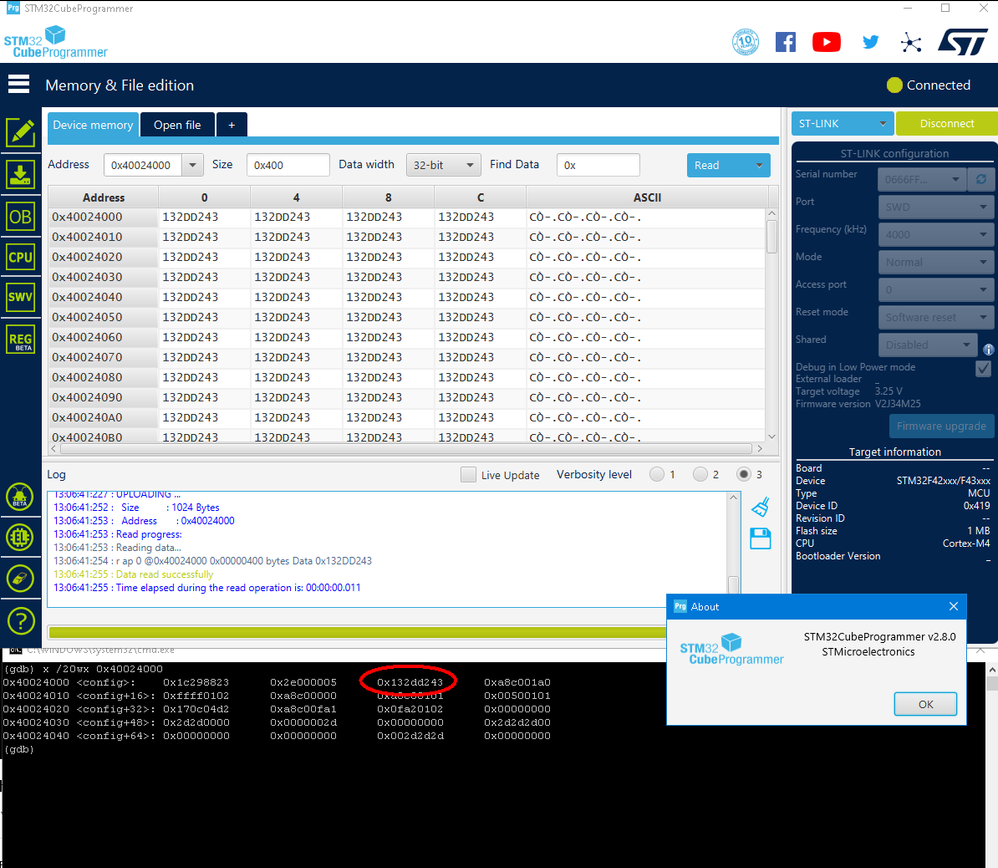

2021-08-11 4:10 AM
Below CubeProgrammer's window is gdb displaying the real content of BKPSRAM.

2021-08-26 7:01 AM
Hello Jan,
I got feedback...
It seems like in the GDB setup you are using the BKPSRAM has been activated previously,
When STM32CubeProgrammer is only reading memory without doing activation.
2021-08-26 7:33 AM
Hi Mike,
What do you mean by *activation* here, in terms of the Reference Manual?
And what should I do to "activate" the BKPSRAM so that it is readable by CubeProgrammer?
Thanks,
Jan
@Mike_ST
2021-08-27 2:30 AM
Hi Jan,
RCC.PWREN set to 1
RCC.BKPSRAMEN set to 1
PWR.BDP set to 1
2021-08-28 12:29 AM
Hi Mike,
Thanks.
So, how do I set those bits in CubeProgrammer, so that I can read out (and eventually reprogram) content of BKPSRAM?
Thanks,
Jan
@Mike_ST
2021-08-30 1:08 AM
Hello Jan,
Go to memory editor part (the same one you shown on the picture), enter the reg address and write desired reg value.
2021-08-31 1:42 AM
Hi Mike,
OK, this works. For read, it's enough to set RCC_AHB1ENR.BKPSRAMEN of course.
CubeProgrammer could do this automatically, though, when access to the BKPSRAM area is requested; I don't see any danger stemming from this.
It also could support write in the same manner, besides PWR_CR.DBP perhaps also setting PWR_CSR.BRE (but that should perhaps be optional).
Can this please be chalked up as a feature request to CubeProgrammer? After all, BKPSRAM is a nonvolatile memory, thus similar in usage to FLASH...
Thanks for your support,
Jan
@Mike_ST
2021-08-31 2:33 AM
Hi again,
"CubeProgrammer could do this automatically"
Actually I asked for that in the ticket. It has been rejected, because we want to display original memory/register state.
You can try automate the process by creating a batch script that call STM32CubeProgrammer with the w32 command to set the 3 registers.
STM32CubeProgrammer\bin\STM32_Programmer_CLI.exe -c port=SWD mode=normal -w32 0x40023840 0x10000000 -w32 0x40023830 0x00140000 -w32 0x40007000 0x0000C100
Then you have to connect in "Hotplug" mode, not "Normal" or under "Reset".
