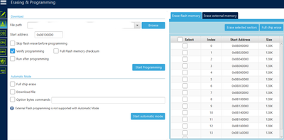

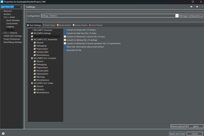

@Andrew Neil In STM32H745 mcu the codes of the M4 core start from 0x08100000 as standard. above I use these options to generate the bin file and hex file.

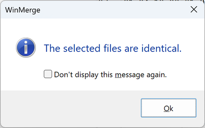

@TDK I will now upload the file contents and test the comparison.

I had a problem with my application that converts from bin to hex, so it was not working when I installed it.
I also paid attention to the addressing event you mentioned. Since it is a bin file, the address information needs to be entered, for this, the “Start address” information must be entered from the “Erasing & Programming” section on the program.
