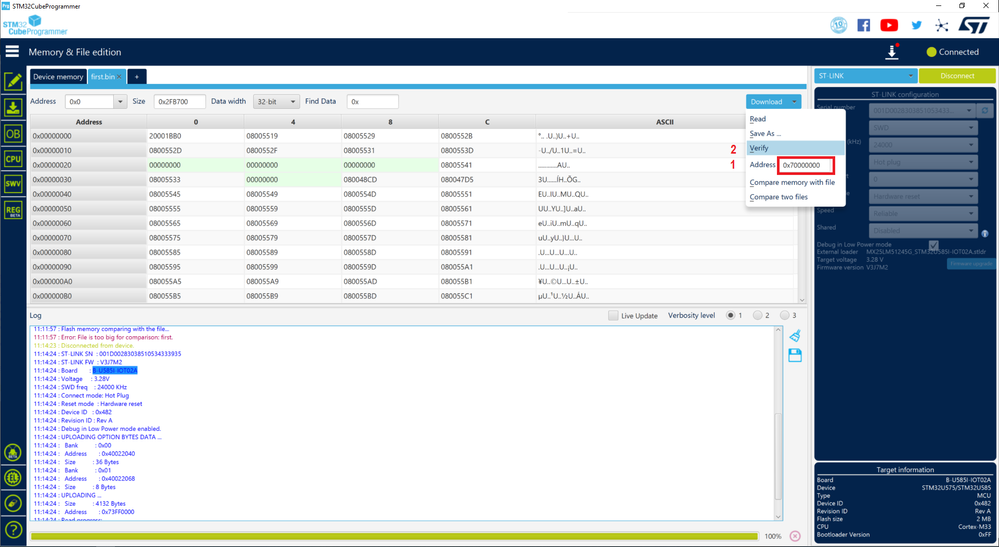

The size of the internal flash memory of an STM32U585AII6Q (mounted in B-U585I-IOT02A ) is 2MB so trying to compare the flash memory with a file that is over 2MB is going to fail with the message "Error: File is too big for comparison"
The file you loaded is in the external flash and not in the internal flash memory. In this case, the "Compare memory with file" is not going to work because it compares the internal flash memory with the file. Instead you need to open the file and specify the address of the external flash and finally click on Verify (please check the following screenshot)
I hope this helps :)

2022-07-27 3:16 AM
Hi
Thanks for the answer. I got verification working.
But there is still one problem. If I try to open file which is about 8 Mbytes or bigger then cubeprogmmer is not working anymore. Anyway verification is now much easier, thanks again.
