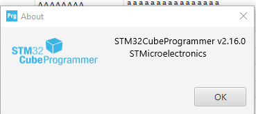

Version: v2.16.0

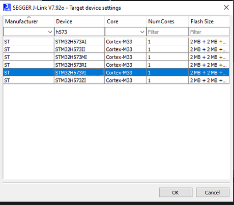

I`ve downloaded and installed the latest application and was told that the CubeProgrammer could support J-Link now.

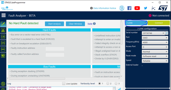

the GUI shows that JLink device can be selected:

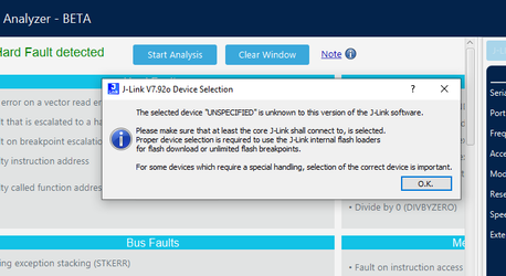

I clicked the connect bottom, the chip select window of JLink was popped out:
after correct chip was selected, the error window showed below:
the error logs like this:
15:30:23 : UR connection mode is defined with the HWrst reset mode
15:30:23 : 20730746
15:30:23 : Error: J-Link - Connection to target failed
15:30:23 : Error: J-Link - Reading CPUID failed
15:30:23 : Voltage : 3.30V
15:31:20 : Error: Database cannot be found. DatabasePath = D:\ProgramFiles\STMicroelectronics\STM32Cube\STM32CubeProgrammer\bin/../Data_Base/STM32_Prog_DB_0xFFF.xml
15:31:20 : Error: flash loader cannot be loaded. FlashLoaderPath = D:\ProgramFiles\STMicroelectronics\STM32Cube\STM32CubeProgrammer\bin/FlashLoader/0xFFF.stldr
I wander if the app support jlink probe, if not, why I can select it?
2024-05-11 1:50 AM - edited 2024-05-11 1:52 AM

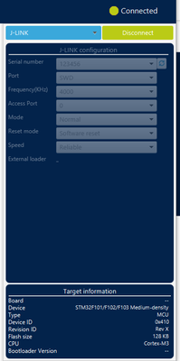

I just tried on my Laptop here, no problem :
Its on Win 10 pro, 22H2 .
ed
Just i remember : my J-link refused to connect to new H7 series, needs some update to connect to this.
So try connect with an "old" cpu, like the F103 i tested here, to check: problem with J-link version or other.

2024-05-11 1:55 AM
So can the J-Link connect using Segger's utilities?

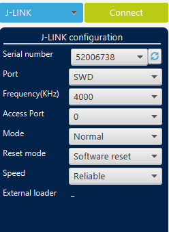

2024-05-14 7:55 AM
As you can see below, the connection between the PC and the J-Link is ok, but not the connection to the target.

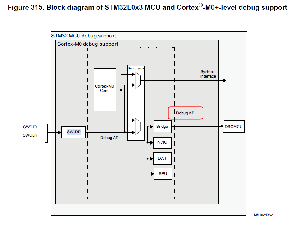

@Meganita wrote:I suppose that "DAP" is "Database Path".
No.
The DAP is the Debug Access Port - the part of the CPU which actually connects to the debug probe:
https://developer.arm.com/documentation/102585/0100/What-is-a-Debug-Access-Port-
So your J-Link is fundamentally failing to connect to the target - it's not related to the CubeProgrammer.
Does your code disable or repurpose the debug lines (SWDIO, SWCLK), and/or put the CPU to sleep?
EDIT:
Example showing the Debug Access Point (Debug AP) - DAP:
EDIT 2:

I'm using STM32L052K8, with J-Link Base. USB 2.0 through direct connection (no hub, no docking station).
I have VTREF connected on pin 1, VSS connected on pin 4, SWDIO on pin 7, SWCLK on pin 9 and RESET on pin 15.
