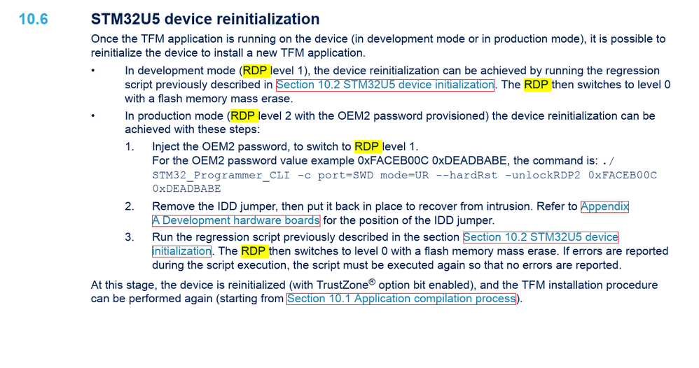

1. last successful action was : programming the option bytes. (probably wrong...RDP set to 1. )

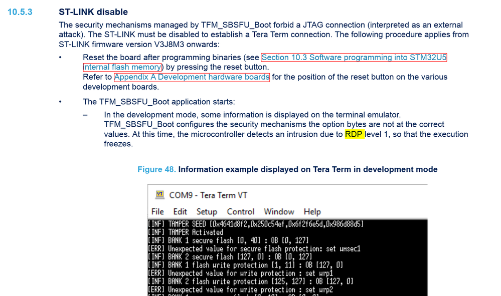

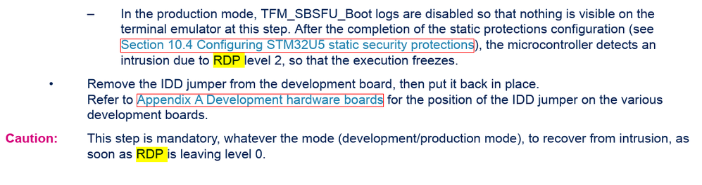

2. disable the st-link, is needed to connect to terminal. YOU have to do it, -> read in um2851 ...complex game.
2024-09-30 3:41 AM - edited 2024-09-30 3:46 AM
Hello @AScha.3
I also tried to do that step of disabling ST-Link, but without success. In fact, to disable ST-Link, "some information is displayed in the terminal emulator" as mentioned. There must be something on the terminal screen (I did a previous project using TF-M, so I know about this). But in my case now, nothing even appears on the terminal screen...
