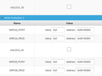

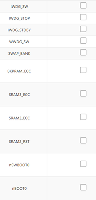

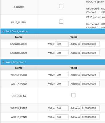

@TDK I mean, option bytes are not checked. Meaning that they are set to zero. I should have said it that way.
When holding down the Reset button, STM32CubeProgrammer connects to the board, and here is what I can see:
As soon as I release the Reset button, it gets disconnected from the board.

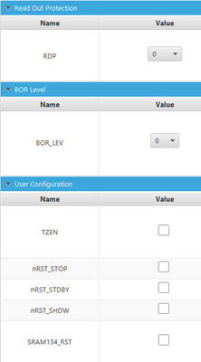

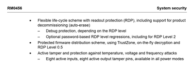

2024-09-26 11:01 PM
No, it has RDP also :

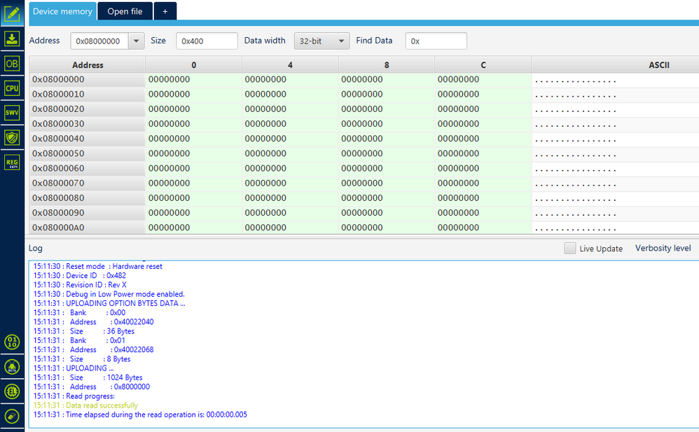

Hello @TDK , here is what I can see on the screen when I connect to the board by pressing the reset button:
The U5 has RDP.

I'm not convinced that you're actually connected there. Reading all 0 in indicative of something going wrong, despite nothing in the log indicating such.

The log, when connecting under reset, shows : it reading the option bytes.
But as you show them: all zero. RDP also ! (This is RDP level 1 on other chips - here it not in the table.)
So no matching rdp byte, could be ->

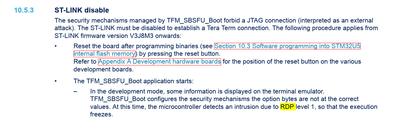

So if its on RDP level 1, maybe you can connect with terminal ...try:
-> read in um2851 ...complex game.
2024-09-27 12:59 PM
There is nothing appearing on the terminal when I connect the board. I also tried to press down the reset button before connecting to the terminal, but there's still nothing on the terminal screen.
I'm not sure that this is related with a RDP level because if it was the case, something should have appeared on the terminal screen.
