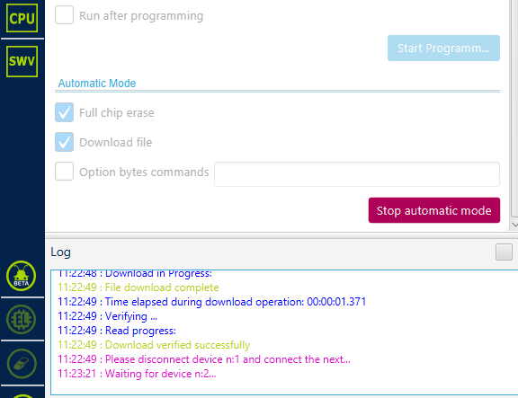

Using ST-link V3.
MCU: STM32L031
First programming was ok. After disconnecting and reconnect with second device, nothing happen.

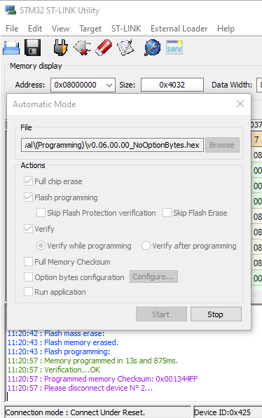

Using same set of hardware, but changed software to ST-LINK Utility.
Result: ok. Automatically programmed the second device.

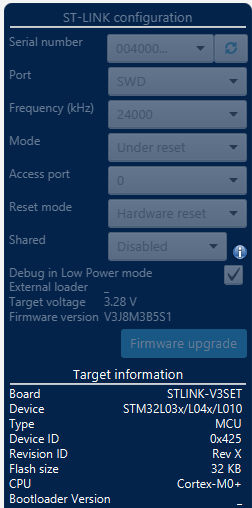

I have updated to latest version (V3J8M3B5S1), then do power cycle of STlink V3 hardware and target board.
Problem is not solved yet. STM32CubeProgrammer was able to detect disconnection, but no response after connected to target board.
Attached is STlink configuration and target info. I have tried reducing frequency until 1Mhz. Problem is still there.
